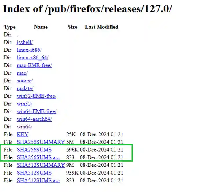

For example, when you download Firefox from Mozilla’s official archive, you’ll find two extra files in the same folder as the installer:
- SHA256SUMS file contains hash values for the installer files.
- SHA256SUMS.asc files has the digital signature of that hash file.
These files help users verify the integrity of the download. If someone tampered with the installer (like adding malware), the hash would no longer match. The digital signature confirms that the hash file itself hasn't been tampered with.
This process makes sure that what you downloaded is safe, unchanged, and really from Mozilla not from a hacker or a fake copy of the site.
