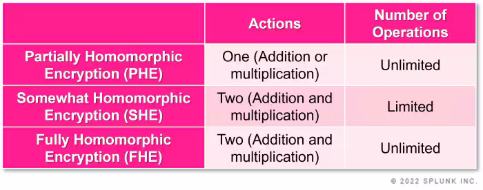

Types of homomorphic encryption
The fundamental difference between the different types is the frequency of mathematical operations that can be performed on the ciphertext.

The main types of homomorphic encryption are partially homomorphic encryption (PHE), somewhat homomorphic encryption (SHE), and fully homomorphic encryption (FHE), each supporting different levels of computation on encrypted data.
