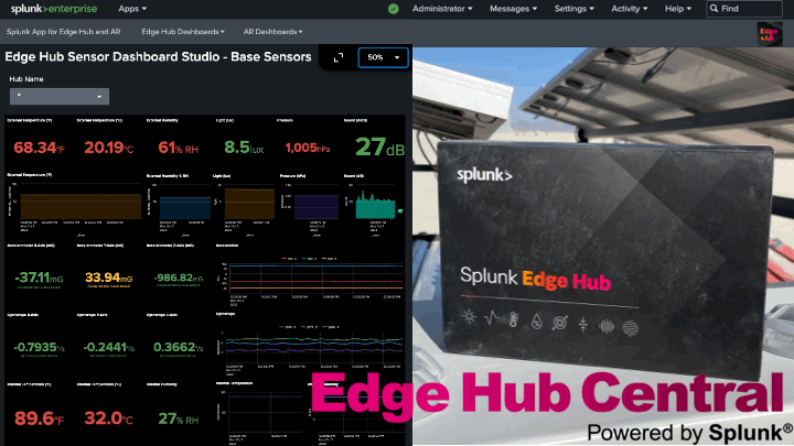

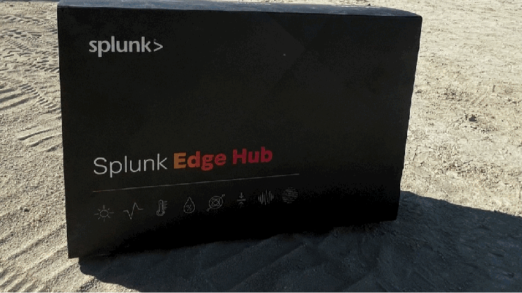

I was able to bring an Edge Hub device to the Black Rock Desert to monitor critical systems of support infrastructure of an art installation. I believe it was a great opportunity to see how the Edge Hub device’s environmentally resistant enclosure would hold up. The environmental conditions are generally hot and dusty. The normal environmental conditions can stress even the most robust equipment and infrastructure. I was not expecting to test how well the device’s shelter held up in a rainstorm. In hindsight a water leak detection sensor could have been useful too! The Edge Hub device was valuable in monitoring and observing support infrastructure and providing data to derive insights in the future using Splunk platform or processed for additional analysis.
My goals in the use of the Edge Hub and Splunk Enterprise server installation were to integrate with an energy meter which emits MQTT messages, and to gather data from the out of the box sensors. I was able to get all of the monitoring equipment and sensors set up as expected in the lab but did run into a few unexpected issues in the field, due to networking equipment. This didn't stop me from gathering a lot of other interesting data from the Edge Hub device.
Monitoring Critical Infrastructure: Illumination
The Splunk Edge Hub device monitored critical infrastructure equipment for an off-grid art museum building which illuminated its galleries from sunset to sunrise. This was important for both the usability of the galleries at night, as well as to ensure no passing vehicles accidentally bump into it during a time of low visibility. It was great to have confidence that there would be enough power reserves in the battery banks to power lights all night. If there was a cloudy or dusty day and production was low we could plan to use additional fuel for back-up generators if utilized.
The project was able to run on solar power successfully with a bit of maintenance to keep things clean. Edge Hub kept on going throughout the week even with dust, heat and moisture in the air.
The device’s built-in and external sensors it let us know:
- Are We Cool: Can equipment function without overheating or limiting battery capacity? We could cool those concerns with the knowledge that we could monitor temperature and humidity to validate operation within expected parameters.
- Under Pressure: Integrating data from the internal pressure sensor helped to let us know if an equipment enclosure was maintaining a positive or negative pressure. With a filtered air input, positive pressure helps to keep out dust and preserve equipment life.
- Humidity: Monitoring the moisture content in the air to help ensure that equipment is operating in optimal conditions.
- Illumination Check: To verify lights and power were on or off for the museum galleries ensuring it was visible to passing pedestrians, bicycles and vehicles.
- Energy Output: Optional external sensors sending MQTT messages for monitoring the solar generator exporting power as needed through the night and importing energy to charge from solar panels during the day.
- Power State: Were solar panels generating enough sun? Was there a possibility of reduced output due to dust? Did low batteries cause the back-up generator to kick in? Validation of each system's state lets us know what is sitting idle, running smoothly, or possibly getting low on fuel.
Monitoring Critical Infrastructure: Do I Have the Power?
The device collected data through the heat of the day, dust storms and rain storms. When there was no Splunk Enterprise server to connect to the Edge Hub device, it was able to successfully backfill data when the Splunk Enterprise server was online again. The device survived the burning hot sun, dust everywhere and rain showering down all around. I was interested in making sure that sensitive equipment stayed dust free, dry and functional. The infrastructure building was successful in keeping the temperature low enough for our batteries to charge. High temperatures can cause the solar generators batteries to stop charging efficiently, so keeping an eye on it was important. The Edge Hub device’s sensor data was easily available to view on the screen so we could validate the temperature, humidity and pressure and external sensors. As the weather changed from hot and dusty to rain with the Edge Hub device recorded sensor data and events for us. This data will help in forecasting future energy needs for similarly sized projects.
