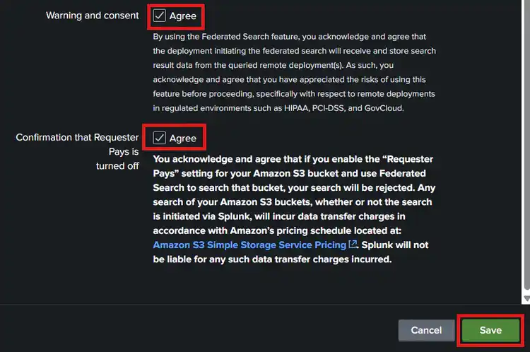

12. Now that we have setup the permissions of Splunk, tick both the agree buttons and Click Save:
This should now have created a federated provider. Let’s now create our federated index for AWS WAF logs.
