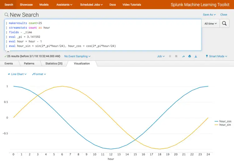

Another approach is transforming the time features so that hour 1 is more similar to hour 23 and both of them are equally less similar to hour 12. To represent the cyclical characteristic, we express date_hour with two features—flexing your trigonometry muscles—sin(date_hour) and cos(date_hour). Let’s take a look at the following chart. The cyclical characteristic is obvious now. By looking at the blue line, we can tell that after the transformation hour 1 and 23 are more similar now and both are different from hour 12.
Also, the blue line says that hour 6 and 18 are similar, which can be wrong in the context of a website’s traffic. That’s why we need the second transformation to introduce the dissimilarity between 6 and 18.

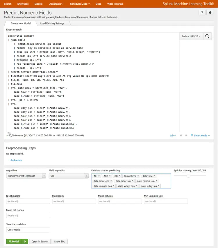

We perform the same transformation on the other two time features we extracted. The following query does it for us.
| eval date_wday = strftime(_time, "%w"),
    date_hour = strftime(_time, "%H"),
   date_minute = strftime(_time, "%M")
| eval _pi = 3.141592
| eval
 date_wday_sin = sin(2*_pi*date_wday/7),
 date_wday_cos = cos(2*_pi*date_wday/7),
 date_hour_sin = sin(2*_pi*date_hour/24),
 date_hour_cos = cos(2*_pi*date_hour/24),
 date_mintue_sin = sin(2*_pi*date_minute/60),
 date_minute_cos = cos(2*_pi*date_minute/60)
By adding these time features, our model will be able to capture seasonalities at three temporal levels. Depending on the application, you might want to remove some of these time features or add other ones, e.g. month or day of month.
Let’s see how these new time features help our model.
Trying it again:
Much better now! The scatter plot looks much better both around zero and higher values—a problem we had with the previous model. R^2 of CHRFModel is greater than 0.91 and the residual histogram has a dominant peak at 0 and fairly short tails, if we ignore the few instances that are more like outliers.

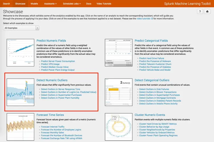

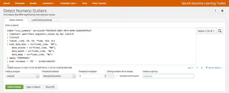

But how do we set the static thresholds? This is the part that needs some investigation. Let's take the search that calculates the residual to the Detect Numeric Outliers assistant.
Splunk Showcase Detect Numeric Outliers
After running the search in this assistant, we choose residual from the Field to Analyze dropdown menu. This menu gets populated based on the fields in the search result. We keep the threshold method to be Standard Deviation and set the Threshold Multiplier equal to 6 (for really extreme anomalies). Also we keep the Sliding Window box unchecked, because we are looking for static thresholds.
After clicking on Detect Outliers, the assistant generates multiple charts showing the outliers in various ways.
We are happy with the thresholds and the anomalies that are detected. But how can you be sure your thresholds are good enough? There’s no easy answer to this question. You need to investigate. If you detect too many anomalies, it might mean that your false positive rate is high. To avoid that, you need to choose a larger threshold multiplier. Choosing a very large threshold multiplier can also cause high false negatives. So, the path to find the right threshold is finding if the anomalies that you find make sense to you and that the anomalies that you know of do also get detected.
Alright, looks like a higher threshold of 4.5 and lower threshold of -4.5 work for us. One last note that we could make a similar guess on what the thresholds should be by just looking at the residuals histogram.

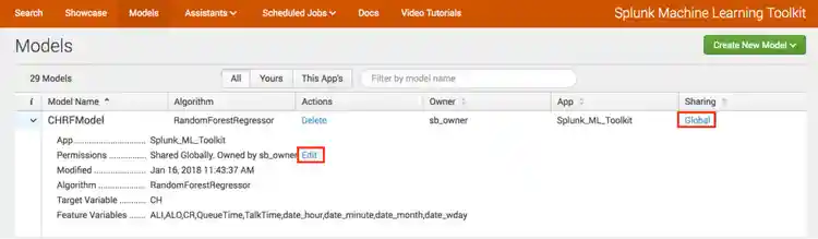

Now that we have a decent model and know how to use it to find anomalies, we need to make the model available in other apps. By default, the models are only accessible within the scope of the app they are built in. For example, CHRFModel is only available in MLTK. We can easily make this model available globally from MLTK.
Click on the Model from the toolbar inside MLTK, find your model, click on Edit, and change Display For from App to All Apps. Once saved, you will see that under Sharing the value changes from App to Global.

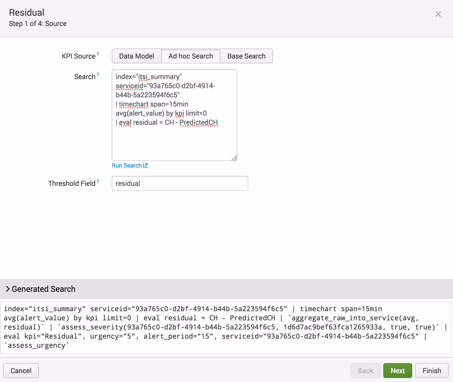

In ITSI, we go to the Call Center service to add two new KPIs, a KPI for the predicted values for CH and another KPI for the difference between the predicted and actual values—residual. Let's start with the first one.
Under the KPI tab, we choose Generic KPI from the 'new' dropdown menu. Let's call this KPI PredictedCH. The following search applies the CHRFModel model on the data and produces a new field called 'predicted(CH)'.
index="itsi_summary" serviceid="93a765c0-d2bf-4914-b44b-5a223594f6c5"
| timechart span=15min avg(alert_value) by kpi limit=0
| fields - Call* ServiceHealthScore
| fillnull
| fields _time, CH, CR, *Time, ALO, ALI
| eval date_hour = strftime(_time, "%H"),
   date_minute = strftime(_time, "%M"),
   date_month = strftime(_time, "%m"),
| apply CHRFModel
The other KPI that we are interested in is the residual.
Next, we set the thresholds we calculated under the Thresholding section in defining the KPI.

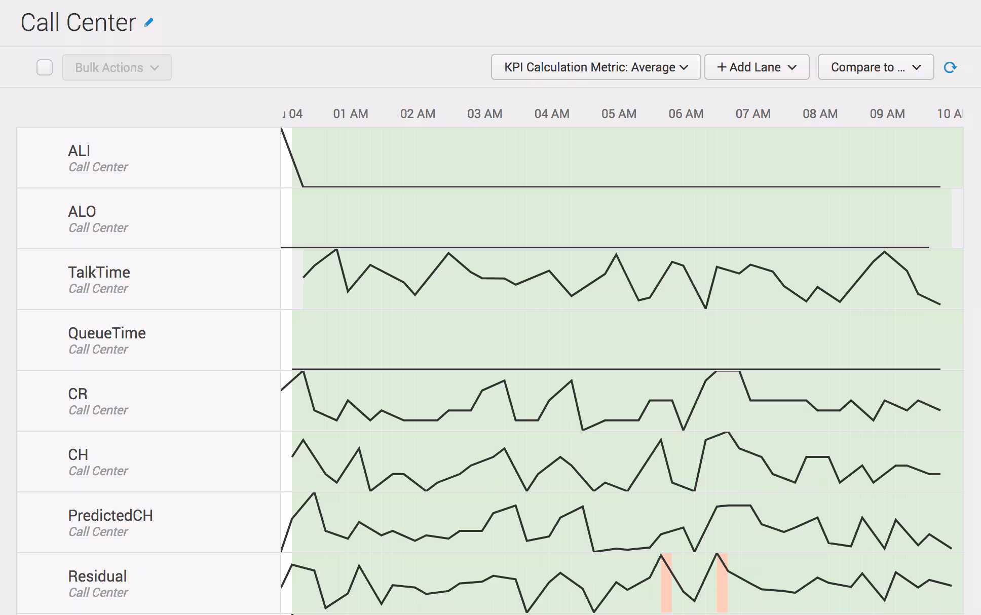

That's it. We're set. Let's take a look at Deep Dive.
Looks like we had some anomalies in the past 24 hours on the Residual detected—yep, that's right, we made a custom advanced anomaly detection system for some ad hoc KPIs, and fed them back into ITSI for actionable intelligence.
