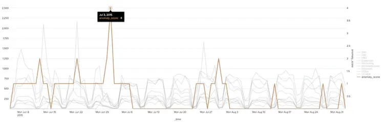

What if I have Multiple Variables?
Now that you’ve seen how to find anomalies on a single variable it’s fairly easy to find them in datasets that have multiple variables – all you need to do is fit and apply more DensityFunctions!
This time we’re going to pick on a different dataset with a few variables in the MLTK, the app_usage.csv dataset. Because this dataset isn’t as densely populated as the cyclical_business_processes.csv data we’re going to break out our anomaly detection by weekdays and weekends rather than hour of day.
| inputlookup app_usage.csv
| eval _time=strptime(_time, "%Y-%m-%d")
| eval DayOfWeek=strftime(_time, "%A")
| eval Weekend=if(DayOfWeek="Saturday" OR DayOfWeek="Sunday","Yes","No")
| fit DensityFunction ERP by "Weekend" into df_erp as outlier_erp
| fit DensityFunction Expenses by "Weekend" into df_expenses as outlier_expenses
| fit DensityFunction HR1 by "Weekend" into df_hr1 as outlier_hr1
| fit DensityFunction HR2 by "Weekend" into df_hr2 as outlier_hr2
| fit DensityFunction ITOps by "Weekend" into df_itops as outlier_ITOps
| fit DensityFunction OTHER by "Weekend" into df_other as outlier_other
| fit DensityFunction Recruiting by "Weekend" into df_recruiting as outlier_recruiting
| fit DensityFunction RemoteAccess by "Weekend" into df_remote_access as outlier_remote_access
| fit DensityFunction Webmail by "Weekend" into df_webmail as outlier_webmail
| eval anomaly_score=0
| foreach outlier_* [eval anomaly_score=anomaly_score+<<FIELD>>]
Cyclical density function
You can see that we have applied a DensityFunction algorithm to the app use metrics for a range of different applications and are then summing the outlier values for each. Alternatively, you could enrich your results and generate an anomaly score from another combination of metrics, such as probability density, distance from mean or deviations from the mean.
