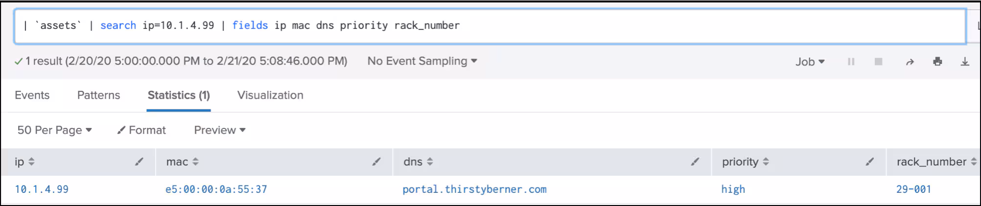

If we click on the frothly_assets_2019 under the column Source, we can see a tabular view of the supporting source data. Sadly, this asset data does not have a rack_number in it. We will add that column in a moment, but for now, I am more interested in the Thirsty Berner ICS Assets, which if I click into, I can see that I have the column rack_number already defined and populated for some assets.
We can see that 10.1.4.99 has a rack number of 29-001. When the two lists converge, even though I don’t have the field rack_number in frothly_assets_2019, the rack_number from Thirsty Berner ICS Assets is returned in the converged asset record and if you look closely, you will notice that the priority from frothly_assets_2019 came across because it has a higher rank over the medium priority in Thirsty Berner ICS Assets. This was something we covered in our first blog on asset & identity framework if you recall, Steven.

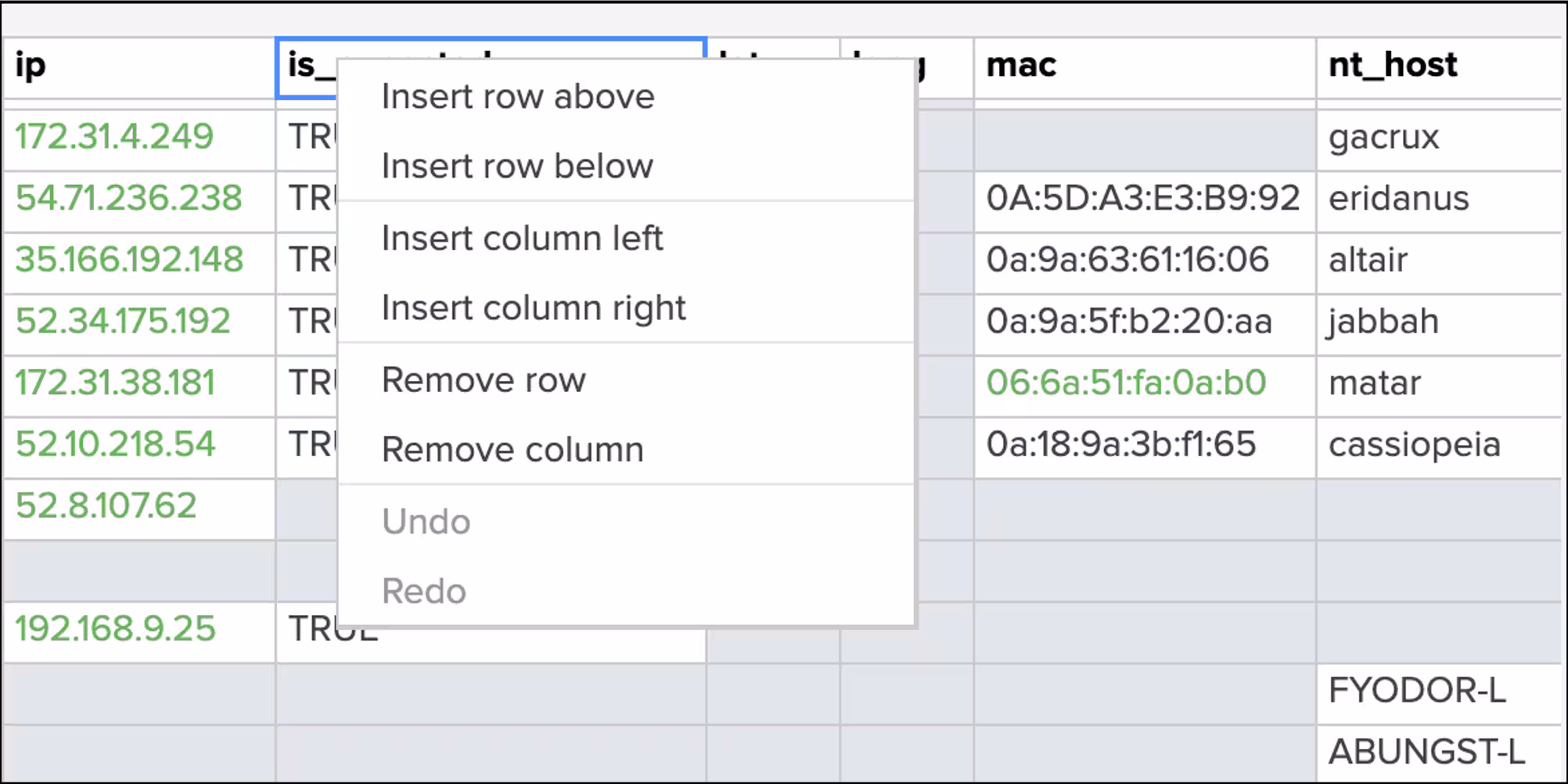

If we wanted to add the column rack_number to previously mentioned frothly_assets_2019 lookup table we can do this directly in the UI. We can right-click, selecting Insert column right and then adding a field name and values into our asset lookup. If we were doing this on a much larger scale, we could originate this new field from an external data source, but it is important that we ensure the field is defined and data is being populated into the Source.

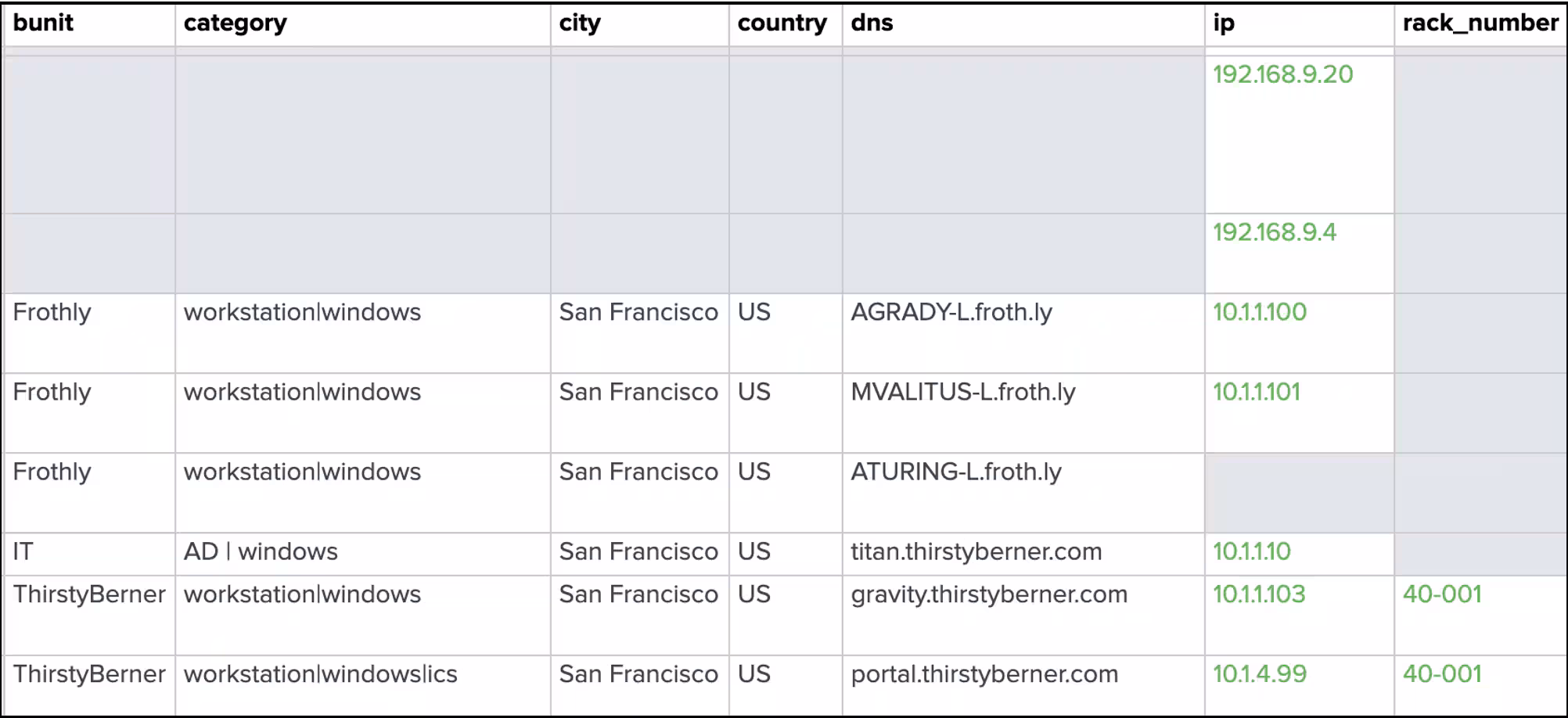

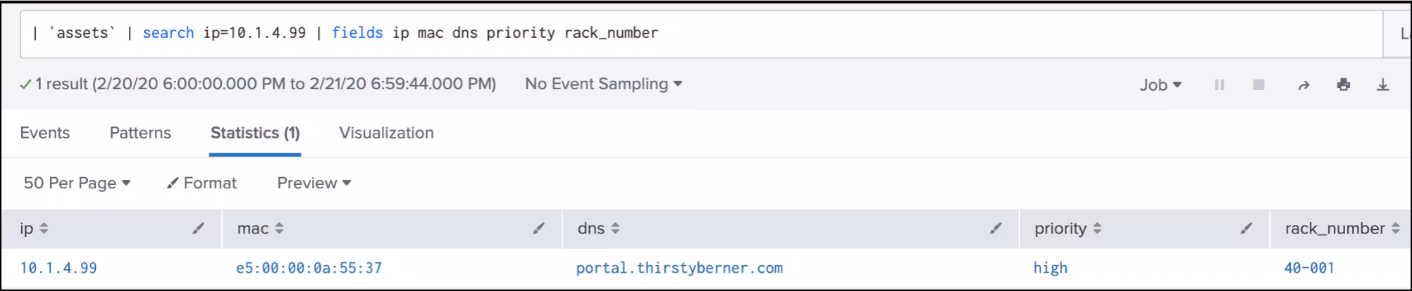

Let’s add a few rack numbers to our lookup, frothly_assets_2019. In a case of poor planning, our admins are not clear about where 10.1.4.99 resides and in this lookup, that system has a rack number of 40-001 assigned to it.
Notice that now when our asset tables converge, the values from frothly_assets_2019 for both priority and rack_number are returned due to its higher ranking.

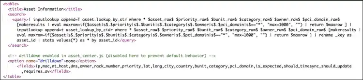

We’ve covered the configuration and creation of the new field, now let’s look at how we can modify content to take advantage of this new field. For this example, we will add rack_number to the tabular Asset Information panel at the bottom of the Asset Center dashboard. Below is the default view.

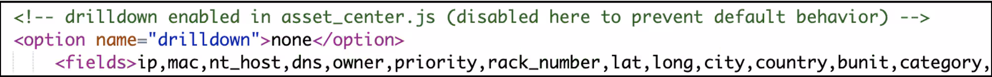

To display the rack number in the Asset Information panel, we can add rack_number in the <fields> section of the SimpleXML. If we wanted to search and filter by rack_number, then additional modifications would be required to pass a token through, but it is no different than any other field at that point.
Here is a zoomed-in version of the row that must be modified with rack_number already added.

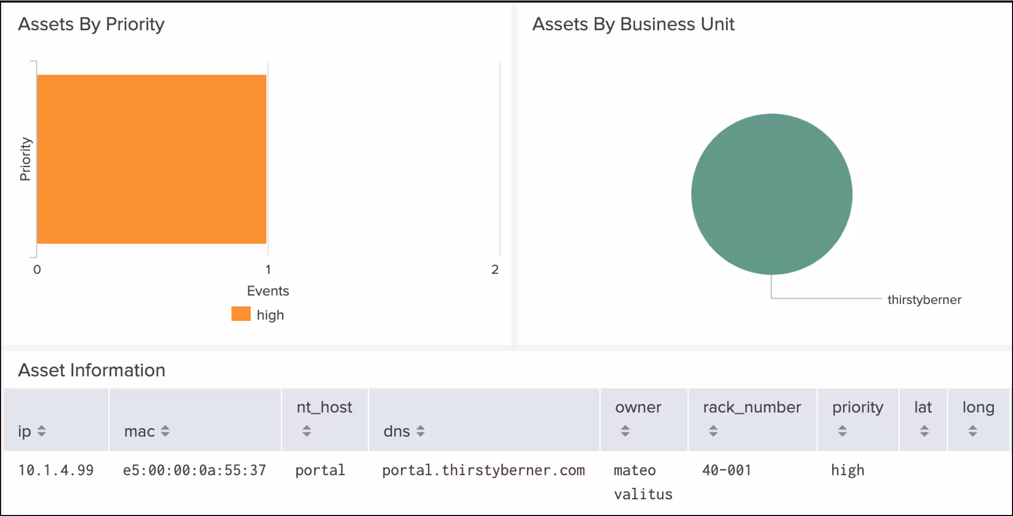

With the field added, we can see that rack_number is now another field in our Asset Information tabular panel. One last comment on this. With version 6.0 of ES, those converged asset and identity lookups are now stored in the KVStore and not in file-based lookups which will provide better performance and remove any risk of an upgrade mashing the csv.
