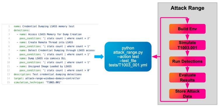

Let’s dig into how our first approach was architected. First, a new argument was added to the Attack Range that would ingest a test file that has predefined configurations. You see an example of a test file below:
The key arguments specifically are:
We created a few of these test files under their respective MITRE ATT&CK technique in the security content repo as we slowly tested them.
The Attack Range was modified to ingest these test files and run through the following process for testing. Build an environment, using Atomic Red Team simulate the technique associated with the detection, run the detection, evaluate its results based on the passed condition. Below is a visual representation of this process:

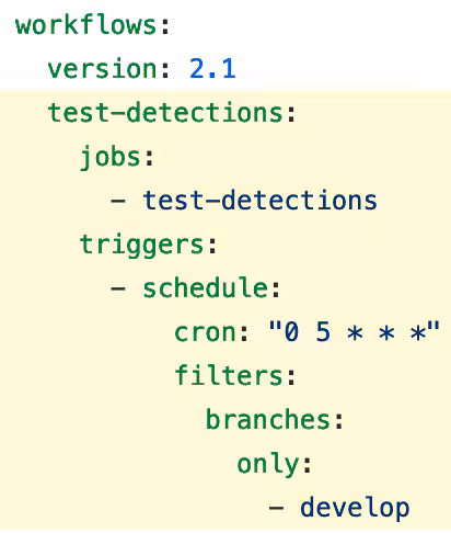

To circumvent this we first started queuing incoming jobs per PR, but it quickly became unusable as we have +10 jobs queued with a test wait time of 16 hours. On our second attempt, we decided to test the detections nightly instead of per PR. To run our detection tests daily we also added a workflow step to our CircleCI configuration file to run the detection. The workflow definition looks like this:
