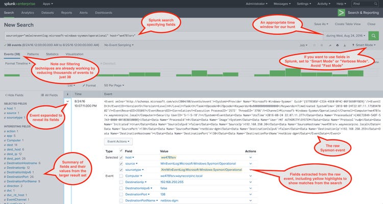

Figure 2 below includes an example of a multi-field search that returns all the Microsoft Sysmon events that came from the system named "we4781srv".
sourcetype="XmlWinEventLog:Microsoft-Windows-Sysmon/Operational"
host="we4781srv"
Note that these sample searches are subject to the time window you chose for the search (see technique 1 above), and they will only retrieve results from the Splunk indexes to which you’ve been granted access. In production environments, it’s a good practice — and sometimes required — to add "index=<myindexname>" to the beginning of your search.
Now, let’s have a look at the additional fields available in these Microsoft Sysmon events.
Figure 2: Examining fields in a Microsoft Sysmon event

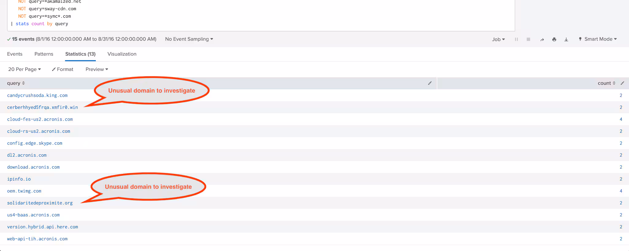

We've now significantly reduced the result set size all the way down to 15! At this point, it becomes much easier to identify things like:
Figure 6: Visually inspecting the filtered data set
