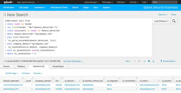

index=email mail from
| stats count by Sender
| rex field=Sender "\@(?<domain_detected>.*)"
| stats sum(count) as count by domain_detected
| where domain_detected!="mycompany.com"
| eval list="mozilla"
| `ut_parse_extended(domain_detected, list)`
| eval company_domain="mycompany.com"
| `ut_levenshtein(ut_domain, company_domain) `
| eval ut_levenshtein= min(ut_levenshtein)
| where ut_levenshtein < 3
In this example, we own the domain “mycompany.com” and someone tried to trick us by sending an email from a domain called “mycampany.com”! The first five lines of the search extract the domain and run the `ut_parse_extended(2)` macro against the domain (we covered that in our last post).
The new part of this search runs the macro `ut_levenshtein(1)` against the newly extracted ut_domain field and compares it to our legitimate domain. As seen in the screenshot above, that distance is one, easily detected by our rule. (Most customers I’ve surveyed use a threshold of 1-2 for alerting; anything more than 2 and you risk getting lots of false positives.)
