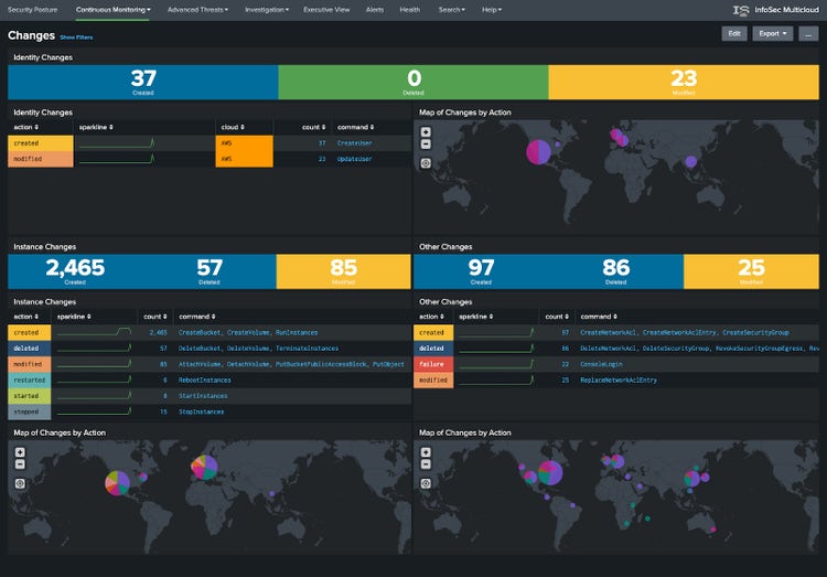

Continuous monitoring provides visibility into changes made to objects in cloud environments.
