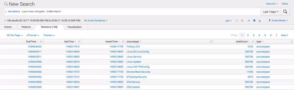

My manager has tasked me to start hunting based on some indicators recently gathered. My first thought is to see that I have data sets available to me that pertain to the time I am hunting in. This is a quick search that I could run to enumerate sourcetypes in Splunk for the past seven days.
As you can see, in the past seven days I have 5,162 FireEye events. Doing a little epoch time conversion, I determine that the data first hit my indexer on May 12 2017 at 2:31:00 GMT and the last time it was seen on my indexer was May 20 2017 22:01:12 GMT.
Based on the time range of my search — May 13 22:00 GMT to May 20 22:38:15 GMT — I have a high level of confidence that my FireEye data is fairly current, but if my investigation goes back before May 12, I don’t have FireEye data to work with, which could impact how I approach this activity or lower my confidence in determining when something was first seen in my network.
