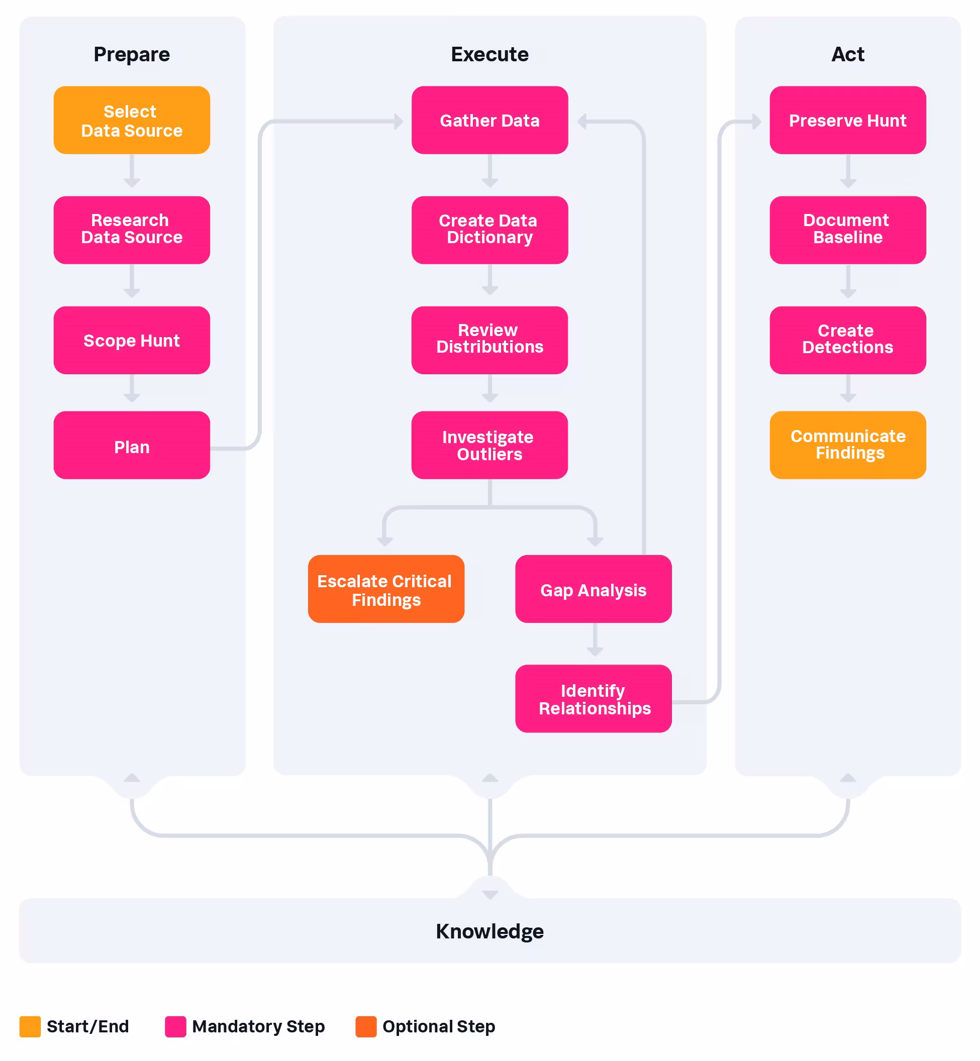

As with all PEAK hunts, baseline hunts are divided into three major phases: Prepare, Execute, and Act. Let’s examine each of these phases in detail.
The PEAK Baseline Hunting Process
Phase 1. Prepare
All hunts start with the “Prepare” phase. This is where you do all the things necessary to get ready and to ensure a successful hunt. Let’s see what this looks like for a baseline hunt.
Select Data Source
The first step is to decide which data source you’d like to baseline. If you're starting from square one, you should make an effort to baseline all of your critical data sources. Start with the ones your hunt team relies on most, or maybe with the most security-relevant sources. If you’re not sure where to start, prioritize data sources according to their significance to your organization and its detection goals.

Phase 2. Execute
With your data sources determined and a plan in place, we move into the “Execute” phase.
Gather Data
Following your hunt plan, it's time to collect the data and bring it all back into one place for analysis. In some cases, this may have already happened (for example, if you’re already ingesting the network logs you need into a Splunk index). In other cases, you might have to identify the specific server(s) and locations on disk from which to collect the data.

Phase 3. Act
Building on our new foundation of knowledge, we can improve our defensive efforts as well as make future hunting efforts easier and more effective. Time to take some action!
