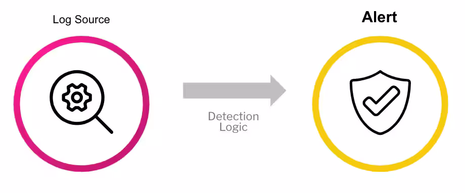

What we’re used to with detection is: I have a log source, I write detection logic for some potential badness on that log source, and that detection makes an alert.

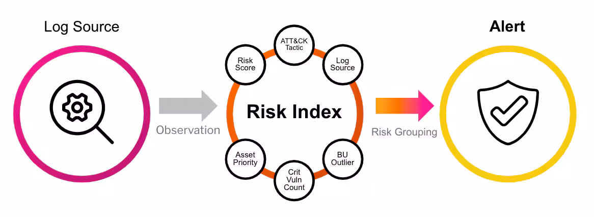

With RBA, I like to think that our detection logic provides observations, then we tag that observation with security metadata and tweak the score based on interesting attributes like privileged user, externally facing server, etc. The alert happens only when we have enough interesting observations.
Let’s break that down a bit further.
We're all probably familiar with using a score of some kind to indicate a risk’s likelihood, severity, or urgency, and that is just one small part of the risk picture. The analogy I like to use is rather than having a flat, unidimensional detection looking for Process Doing Bad Thing – which we may have to spend weeks tuning to keep alert volume reasonable – I'm just storing anything that is interesting by that host, user, or ID and putting it into its own special bucket. I will create an alert only if there are enough interesting things in the bucket. This translates to truly boggling alert volume reductions and alert fidelity increases we regularly see from customer implementations. You can still have your high-fidelity, always-investigate alerts, but this method is ideal for so many detections.
When I put something in that bucket (what we call the risk_object), not only can I add other useful security metadata like the MITRE ATT&CK tactic/technique or what data source this came from, I can also tweak the score using information about that object. So maybe this is a public facing production server or database, or this system has a known vulnerability, or this user's business unit definitely shouldn't be running these types of commands. Conversely, maybe their business unit regularly runs these types of commands and we might tweak that lever in the opposite direction for specific commands. One of my favorite parts of RBA is the creativity we have to add knobs and levers as needed to tweak the way our alerts bubble up without allowlisting. It’s always exciting for me to hear about interesting levers people used to solve their specific problems.
In addition, RBA stores the activity or behavior performed by that risk_object as a threat_object. This becomes a useful pivot point to see what other objects in our environment are interacting with this IP address or executing this command, giving us another lens to view regular or irregular activity. This gives us a whole new lens on our logs to determine what our objects are doing or what is happening on certain objects. So I could investigate the system acme-host as the risk_object or take a look at its threat_objects: the strange IP address 123.123.123.123, the command-line powershell.exe ExecuteMaybeBadThing, and the filename ReallySensitiveInfo.xlsx from various risk rules.
I found this helpful when I tuned to see how many other systems or users performed some activity that bubbled up into an alert, or to see at a glance which risk objects and threat objects interacted whenever we identified red team activity. There are also creative ways to create alerts off of threat objects themselves, or build some dashboards that slice up your risk index by these objects as a sort of threat hunting queue.

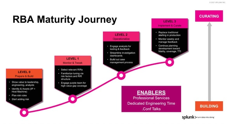

The way I see this journey progress is outlined below, and I will explain further in an upcoming blog.
How Do I Get Started?
That’s a great question! Let’s tackle this in the next blog, but you can check the last few years of .conf videos to get more ideas. Keep up to date by subscribing to Splunk Security Blogs or following me on Twitter!
