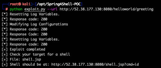

For the fun part, Spring4Shell, or CVE-2022-22965, has a much broader proof-of-concept (POC) code available to test with. STRT gathered some of the POCs available on GitHub and pulled out the artifacts of interest, which are the URI and data or payload. As previously built, this time the POCs required Tomcat9 installed and hosting a simple vulnerable Java application. STRT looked at both endpoint and network for detection opportunities.
This exploit works in the following manner and SnapSec provided a great walkthrough from beginning to end.

After a successful exploitation the URL will be shared and from the sampling the following are provided:
Exploit The following sample was used to validate the vulnerability https://github.com/reznok/Spring4Shell-POC . Each attempt worked and a shell.jsp was written to disk and by visiting the site a response would be provided.
