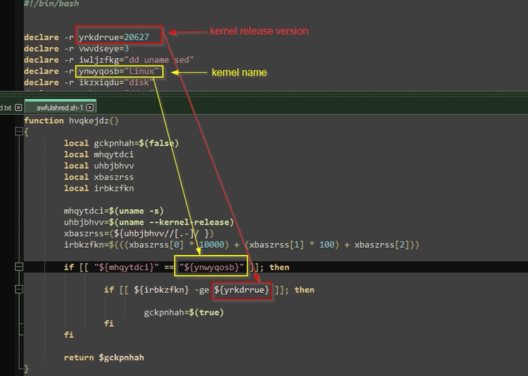

Bash Version and Linux Release Checking
This Linux shell script wiper checks bash script version, Linux kernel name and release version before further execution. Based on the reviewed sample, the bash version AwfulShred needs to continue its code is base version 3.
Using the “uname -s” and “uname –kernel-release” to retrieve the kernel name and the Linux kernel release version. Figure 1 shows its code, how it checks if the kernel name is “Linux” and the kernel release version must be greater than or equal to 2.6.27.

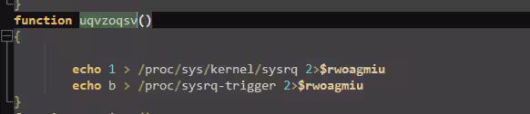

Magic System Request Key for Reboot
Lastly, after all the wiping and payloads of this malicious script, AwfulShred reboots the compromised host using the system request kernel object. Figure 6 shows the 2 lines of code that enable all the functions of sysrq (“echo 1> /proc/sys/kernel/sysrq”) and reboot (“echo b > /proc/sysrq-trigger”) the compromised host that makes it inoperable after the restart.

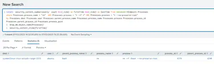

Linux Data Destruction Command
This analytic identifies a Unix shell command that can wipe root folders of a Linux host. This commandline is being abused by Awfulshred malware that wipes or corrupts files in a targeted Linux host. The shell command uses the rm command with force recursive deletion even in the root folder.
| tstats `security_content_summariesonly` count min(_time) as firstTime max(_time) as lastTime from datamodel=Endpoint.Processes
 where Processes.process_name = "rm"  AND Processes.process IN ("* -rf*", "* -fr*") AND Processes.process = "* --no-preserve-root"
 by Processes.dest Processes.user Processes.parent_process_name Processes.process_name Processes.process Processes.process_id
 Processes.parent_process_id Processes.process_guid

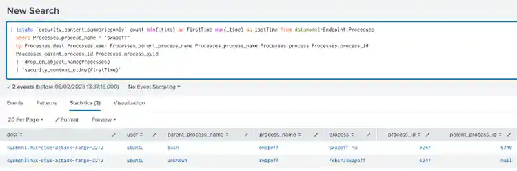

Linux Hardware Addition SwapOff
This analytic looks for process execution to disable the swapping of paging devices. This technique was seen in AwfulShred malware that disables the swapping of the specified devices and files.
  where Processes.process_name = "swapoff"

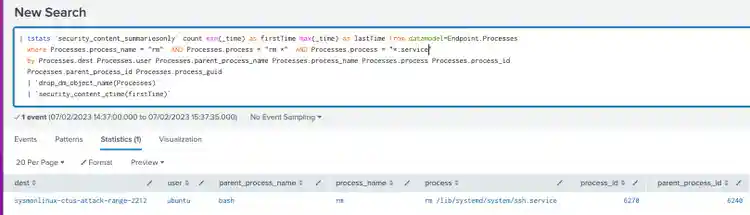

Linux Indicator Removal Service File Deletion
This analytic looks for suspicious Linux processes that delete service unit configuration files. This technique has been observed in several payloads that delete service configuration files to corrupt operating system services or security products as part of its defense evasion.
  where Processes.process_name = "rm"  AND Processes.process = "*rm *"  AND Processes.process = "*.service"

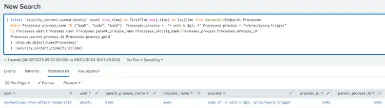

Linux System Reboot Via System Request Key
This analytic looks for possible execution of SysReq hack to reboot the Linux system host.
This technique was seen in AwfulShred malware wiper to reboot the compromised host by using the Linux magic sysrq key. This kernel configuration can trigger reboot by piping out 'b' to /proc/sysrq-trigger after enabling all the functions of sysrq.
  where Processes.process_name IN ("dash", "sudo", "bash")  Processes.process =  "* echo b &gt; *" Processes.process = "*/proc/sysrq-trigger"
