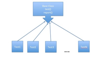

The first thing I did was to redesign the whole approach to use object oriented programming techniques to create repeatable vulnerability testing code in C++. (Please excuse some of the programming jargon as I had mentioned that I was going to go over development first before getting to the point of using Splunk). I created a base class that had two methods, test() and report(), that were meant to be overridden by implementation classes. Each implementation class would be used to conduct a specific vulnerability test given a set or range of input IP addresses or DNS names. As you can foresee, they first called their test() method to perform the scan and then called their report() method to log their results to the file system. The hierarchical approach can be summarized with this diagram.
Class Hierarchy
The non-exhaustive lists of tests included vulnerabilities found using telnet, ftp, finger, rlogin, rsh, ping, etc. Anyone could implement a future test by inheriting from the base class and registering themselves with the main calling program which started off being multi-process, but could easily have been rewritten to be multi-threaded. I also implemented a fat client GUI to initiate the vulnerability scanning and to view the results.

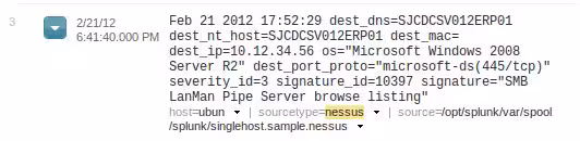

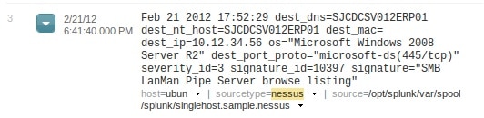

Let’s head into more modern times and look at what Splunk can do with very little effort against sample vulnerability scan data. I’ve used Nessus as the scanner in the examples, but the same principals should apply to your own favorite scanner. A sample event may look like this:
Nessus Event

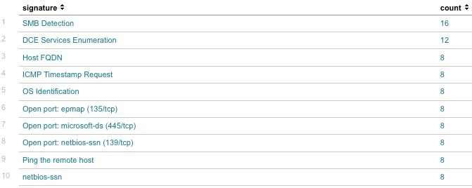

It is mostly unstructured, but some of the fields will be extracted automatically by Splunk at search time as they are in key=value format. My first report may be similar to the one I described above where I want to find a count of all signatures (vulnerabilities are now called signatures) found. The Splunk search could be:
sourcetype=nessus|stats count by signature|sort - count
Stats for Vulnerabilities

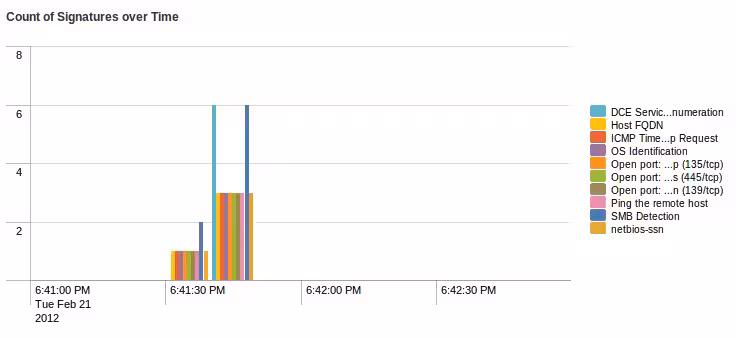

Now, let’s try something a little more graphical where I would like to see a graph of these same signatures over time using a column graph. In the old days, TCL would not have been able to do this and I would have had to spent some time learning and using the accompanying TK language for the chart. In Splunk the search is as follows using a custom time range:
sourcetype=nessus|timechart count by signature span=30s
Timechart Vulnerabilites

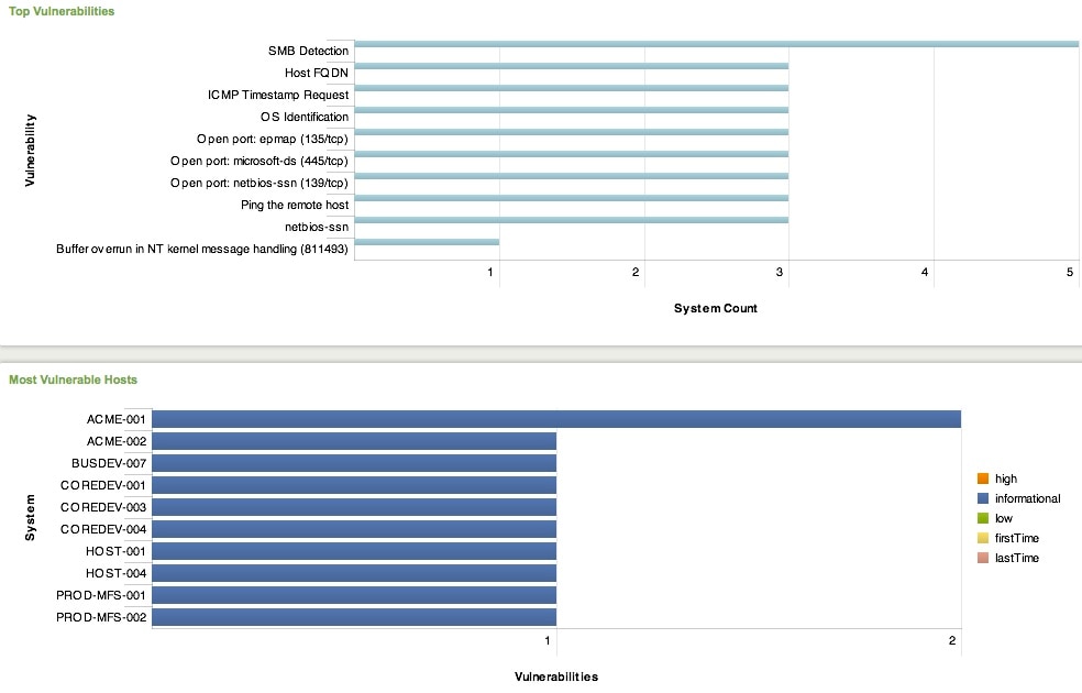

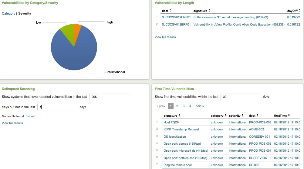

If you like the these reports for your vulnerability scanner, then you may also want to consider Splunk’s ES 2.0 offering, which has vulnerability scanner reports and related correlation searches as a sub-domain for the network portion of its monitoring. These are much more professional reports than the ones I just showed you as they take into account summary indexing to scale the aggregate reporting to massive amounts of data and also correlate the data with events from other security devices to give you a more complete security posture. For the reports to work out of the box, you will need to alias your field names to use the Splunk Common Information Model and create a few tags and eventtype definitions for your events. ES 2.0 already does this for the Nessus sourcetype. Here are some partial dashboard views:
Top Vulnerabilities
Vulnerabilities Category
