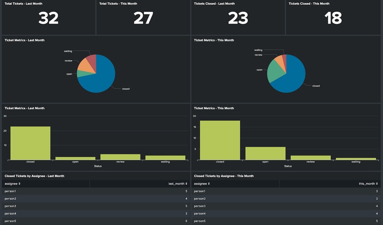

Don’t:
Don’t have multiple panels displaying the same thing. There are multiple pie charts displaying Last Month and This Month data and then subsequent column charts with the exact same information.
This entire dashboard is essentially different visualizations for the same data, except for the last table.
There are two separate tables that could very easily be displayed as one table.

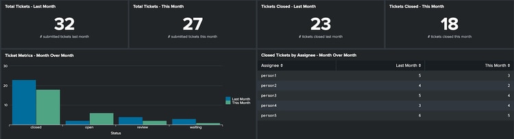

Do:
Combine any duplicating information and remove redundant visualizations. Consolidate the rest of the panels and reorganize dashboard structure to remove excess white space.
Add descriptions under single values if it adds value or context.
If adding legends to visualizations, adjust the placement as well as try to keep the legend keys short, so that they are able to display without ellipses.

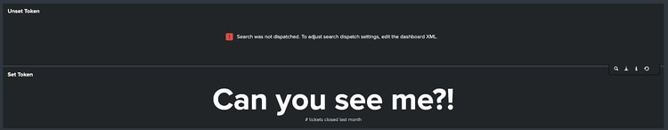

- One thing I wasn’t aware of until somewhat recently was that searches can have the depends argument added to it, similar to adding it to panels when hiding or displaying them, so that a search will only run when the depends statement is true. This can be so helpful if there are drilldown searches that don’t need to run when the dashboard is loaded, for instance.
<dashboard theme="dark">
<label>search_depends</label>
<description>test</description>
<init>
<unset token="dont_run"></unset>
<set token="run"></set>
</init>
<row>
<panel>
<single>
<title>Unset Token</title>
<search depends="$dont_run$" id=”dont_run”>
<query>|makeresults|eval data="Can you see me?!"</query>
<earliest>-24h@h</earliest>
<latest>now</latest>
</search>
<option name="rangeColors">["0x53a051","0x0877a6","0xf8be34","0xf1813f","0xdc4e41"]</option>
<option name="underLabel"># tickets closed last month</option>
</single>
</panel>
</row>
<row>
<panel>
<single>
<title>Set Token</title>
<search depends="$run$" id=”run”>
</search>
</single>
</panel>
</row>
</dashboard>
- Last, but certainly not least, set an id to each search! Whenever there comes a time that a dashboard search needs to be found in the audit logs, if the search has an id attached to it, it becomes much easier to find. Troubleshooting made easy...well, easier.
